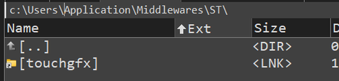

ferro
Lead
On Windows, you can create a directory junction (also called a soft link)
Navigate to your project folder Middlewares\ST\. Delete touchgfx folder and run following in command line (need to be admin)
mklink /D "%cd%/touchgfx" "c:\TouchGFX\4.24.1\touchgfx\"
