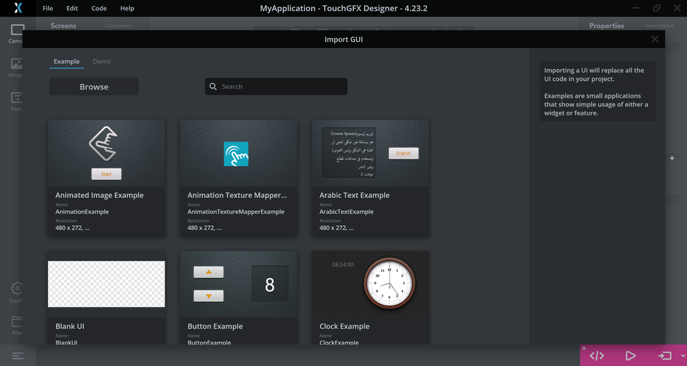

I am using the TouchGFX designer to create project and source files , afterward import the project to CubeIDE.
I am using TouchGFX 4.23.2 and CubeIDE 14.1 .
I've seen many question regards this topic , but surprisingly none of the advices solves this very basic problem for me.
After creating the sources in TouchGFX, I am opening the CubeIDE workspace in the project root (not inside CubeIDE folder.
From that location I've tried the following:
1. File -> Open Project From File SYstem -> Directory:
    Show two projects. One of the called as the TouchGFX project and the othe called CubeIDE.
    None of them is exports nothing to the CubeIDE.
2. Import Project -> Existing Project Into Workspace:
    Import a project that *always* called CubeIDE, although in .project file there is another name.
    In addition the .ioc file has another name.
    Renaming the files currently did not succeed, therefor I failed to create 'operational' project.
Please guide how should the user create a simple project in the TouchGFX designer and then import it into the CubeIDE.

Hello @dgold.1 ,
I understand the point you are making. This is because the demos and examples available on TouchGFX Designer are based on the simulator, so, they can be easily imported into other project.
If I've understood your situation correctly, you don't have a TouchGFX project generated by STM32CubeMX. Instead you have a GUI example instantiated from TouchGFX Designer, and you want to connect it to you STM32CubeIDE project. The easiest way to do this is to create an empty TouchGFX project as I mentioned in the previous response, and then go to Edit -> Import -> GUI
Importing GUIImporting GUI
 Here you can choose to import either an example, a demo, or even a GUI that you have created previously (by clicking on Browse).Then all the required files will be added to your project and they will be reflected in your STM32CubeIDE project as they should be.
If you do not want to use TouchGFX at all in your STM32CubeIDE project and just want to add the files inside your TouchGFX project to the STM32CubeIDE, then the process won't be straightforward. You will need to handle many things because the TouchGFX generator provides TouchGFX HAL to connect your hardware to your GUI, and without them, your application won't run correctly.

Hello @dgold.1 ,
I hope this helps you
