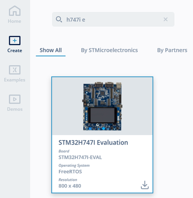

Could you try to follow this process instead:
  1. Open TouchGFX Designer.
  2. Go to the "Demos" tab.
  3. Press "Select Board Setup".
  4. Select "STM32H747I Evaluation".
  5. Select "TouchGFX Demo 2" and press "Create".
  6. Press F6 or click the "Program and Run Target" button.
You can also debug it directly in STM32CubeIDE, but I recommend first verifying that it works using the procedure described above.

Hello @Pieter25.
Which example project are you trying to run?
Could you test the TBS for STM32H747I-EVAL available in TouchGFX Designer? I believe this project should also work for STM32H757I-EVAL.

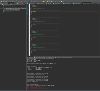

In STMCube32IDE, I followed these steps:
  1. File > New > STM32 Project.
  2. Selected Example Selector tab.
  3. Type STM32H757I-EVAL for Board, and select the TouchGFX example (see image below).
  4. Used all the default settings.
  5. Build the project.
  6. Create new debug connection to debug the TouchGFX Release that was built.
  7. Select MT25TL01G_STM32H747I-EVAL.stldr as external loader.
  8. Debug the application.
Is there something I missed or did wrong?
I've tried going into compiler options and compile with -g and -Og (to enable debugging and disable speed optimisation) but it made no difference. I can at least see the HardFault() after adding debug symbols (-g). Below is a screengrab of where it gets stuck in HardFault, and the call stack does not help me much.

January 23, 2026
Hello again.
Best regards,
Johan
Pieter25Author
February 9, 2026
Thanks for your response. It is a pity that I do not know what was wrong with the first project, but the one from TouchGFX worked, and did not generate HardFault.
