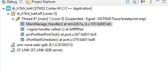

IB.1
Hi Alexandre,
Thank you for your replay. I did try step debug., and crash happen when executing
 osKernelStart(); Please see screenshot bellow.
Please advise what else we can try.
Than you,
I
