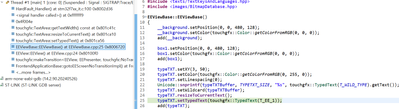

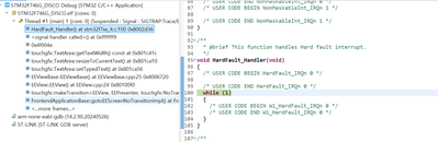

I am experiencing a HardFault on an STM32F746G-DISCO board while working with TouchGFX. The issue seems to be related to code automatically generated by the TouchGFX Generator in STM32CubeMX.
The fault occurs when my application tries to set text on a TextArea widget. The debugger stops inside the HardFault_Handler, and the call stack clearly indicates the issue originates from the setTypedText() function chain.
Here is the relevant part of the call stack from the debugger:
  • HardFault_Handler()
  • touchgfx::TextArea::getTextWidth()
  • touchgfx::TextArea::resizeToCurrentText()
  • touchgfx::TextArea::setTypedText()
  • ... (my application code, which was generated by the generator)
It seems that a call to setTypedText(), which is part of the generated code, is leading to the HardFault. I suspect this might be caused by an uninitialized TextArea object or a configuration issue within the generator, but I'm having trouble pinpointing the exact cause.

JIN3473
I forgot to attach the screenshot in my original post. Here it is

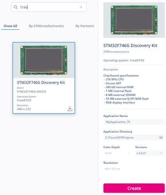

JohanAstrup
Hello @JIN3473.
Are you using the TBS available in TouchGFX Designer, and if so, are you using the latest version (v3.0.27)?
What board revision do you have? You should be able to check this on the sticker located on the back of the board.
Best regards,
Johan
Hello, thank you for your reply.
I am not using the official ST Discovery Kit. Instead, I am working with a custom board based on the STM32F746MGH6 MCU.
My LCD resolution is also different; it is 480x128. Therefore, I am not using the TBS (Target Board Setup) provided by the TouchGFX Designer.
JohanAstrup
OK, sorry, my mistake. I was just confused about you experiencing a hard fault on an STM32F746G-DISCO.
Have you used the TBS as a reference for your board setup?

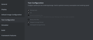

Hello Yohan, thank you for the detailed questions.
  • Regarding TBS: I did not use the TBS as a reference since I'm working with a custom board.
  • Text/Font Storage Location: I've attached a screenshot of my Text Configuration in TouchGFX Designer. With the 'Mapped storage format' option enabled, my understanding is that the font and text data are intended to be stored in the memory-mapped external QSPI flash. However, if you could provide a method to verify that this configuration correctly places the data into the external flash, I would be very grateful.

JohanAstrup
As the first step, I recommend testing a simple GUI with a box to verify that the system functions correctly. If it works with the box, try to insert an image stored in external flash as well.
Enabling the Mapped storage format option does not automatically place fonts in external flash. It is the responsibility of your linker script to handle this.
Could you share your linker script and map file? The map file allows you to verify the placement of your assets.

JIN3473
Hello Yohan,
Thank you for your follow-up and suggestions.
I wanted to provide an update on my progress. I have resolved the HardFault by modifying the linker script. I changed the output section for FontFlashSection and TextFlashSection from >QUADSPI to >FLASH, and the application now boots up correctly.
Essentially, the problematic definitions were FontFlashSection : { ... } >QUADSPI and TextFlashSection : { ... } >QUADSPI.
Interestingly, I have been using the QUADSPI flash for both images and text for over a year without any issues until now. This makes me suspect that my custom .stldr (external loader) might not be completely stable, which could be the root cause of this recent problem.
For now, I will proceed by using the internal flash for these sections to ensure stability.
