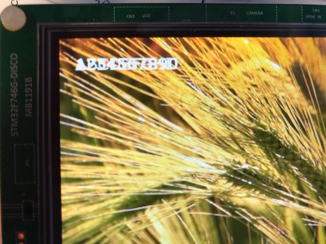

I'm trying to update the contents of a textArea from a freeRTOS task but I have a problem on the second iteration... it seems that the new text is written on top of the old ones... even if I call the Invalidate() methods as reported below:
void Screen1View::setMessage(char* message, int msglen)
textArea1.invalidate();
Unicode::strncpy(textArea1Buffer, message, msglen);
textArea1.setWildcard(textArea1Buffer);
textArea1.resizeToCurrentText();
why is this happening ? shouldnt invalidate() do all the magics ?

I found the problem. Try deleting interaction1 - It fades image1 (background) to 0 alpha, so essentially you have no background when you try to render text on top. The background image isn't updated properly on the canvas by the interaction because the framebuffer is immediately beneath it (there is nothing to blend with) - so that might have confused you. Once you've done that, you will now see the problem with "resizeToCurrentText" that we discussed previously.
But essentially you're using texts with wildcards in the right way (except for your resizing issue)

The reason you're seeing old text as well is because your new text is shorter and now you're (most likely) seeing the tail of the old text. In this case you're not invalidating the "tail", if you get my meaning, because you resized the text area and you're telling TouchGFX to only invalidate the new, smaller rect.

Unfortunately, it doesn't seems a size-related problem... as it affect the whole text and not only it's tail...
Attached you can see a screenshot of the screen... the two texts are "1234567890" and "ABCDEFGHIJ" and they overlap as if the 2nd one was just printed on top of the 1st one.

That's extremely peculiar. A call to invalidate() will force the rect that covers the textarea to be updated based on the contents of the TypedText.

Is this a problem on both Simulator and Target? You'd get this kind of behavior too if you did not have a background behind the text area, but it seems like you do.
