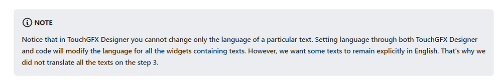

Indeed, changing the language of you application will affect all your text areas, as described in the tutorial 6.
0693W00000aIvsyQAC.pngBut thanks for the suggestion, I can discuss it with the team.

I did the tutorial few weeks ago but missed/forgot about the Note. Thanks for confirmation and link.
