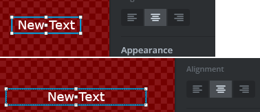

When Text Area changes X dimesion text is aligned in the center automatically - horizontal alignment

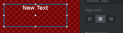

However, when Y dimension is changed text stays always at the top.
So I wonder how to achieve center and bottom text alignment - this is what I mean by "vertical alignment".

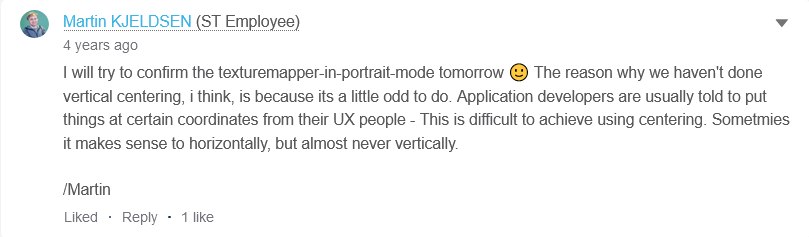

However, I found this very interesting comment from Martin KJELDSEN on why it was not implemented:

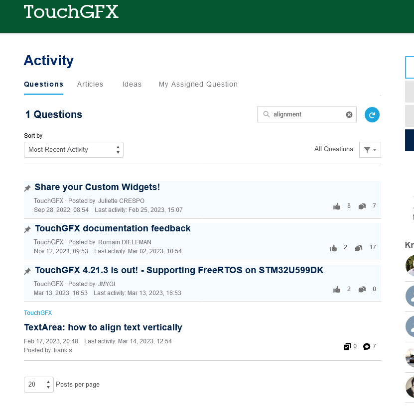

And thank you for the link ! Here is collection of related posts I found:
How to make a Text to be align centered vertically ?
Text Area and alignment
It is unfortunate that they are not listed when searching the forum (with 'align' or 'alignment'):
