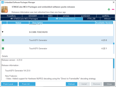

Note : TouchGFX Designer 4.23.1 MUST be used with STM32CubeMX 6.10.0 or above (link to download STM32CubeMX).
Attention : If X-CUBE-TOUCHGFX 4.23.1 is not available in STM32CubeMX software yet, please navigate to "Help > Manage embedded software packages > STMicroelectronics > X-CUBE-TOUCHGFX". Then click on "From Local ..." and navigate to the x-cube-touchgfx-4-23-1.zip file to install the new pack inside STM32CubeMX.

I have one problem on TOUCH GFX 4.23.1 and Cube.MX 6.10.0.
I created a STM32F746G_DISCO project with GFX, and generate codes without any modifying.
Next, open STM32F746G_DISCO.ioc with Cube.MX, found following warning.
I searched new X-CUBE-TOUCHGFX package, but latest version in Cube.MX is 4.23.0.
How can I clear this waring?

Here the exact same problem. Downloaded the latest version of CubeMx (6.10) and cannot find TouchGFX 4.23.1
How can this be solved?

Hello
Check the initial message of this thread:
So you must manually install the latest TouchGFX version to the CubeMX. Also here discussed about same problem
https://community.st.com/t5/stm32-mcus-touchgfx-and-gui/can-t-open-ioc-the-cmsis-pack/td-p/635622
hope this helps.
Br JTP
Hi JTP,
Thank you for your reply.
I tried your suggestion, and installed GFX 4.23.1 to Cube.MX successfully.
Thanks!!
