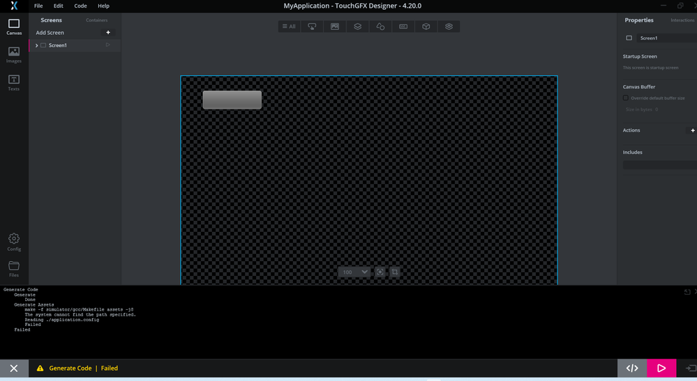

0693W00000WHVSIQA5.pngI am facing this issue. always says system can not find specified path. what is this error?

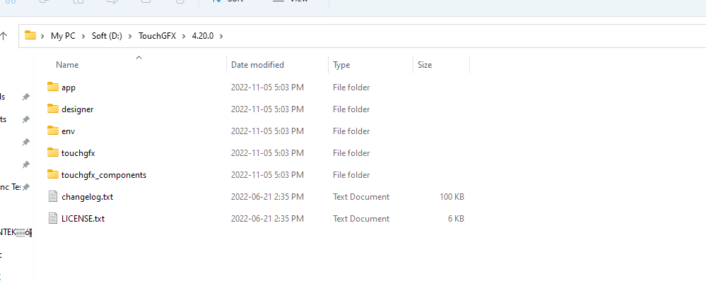

this is my installation path

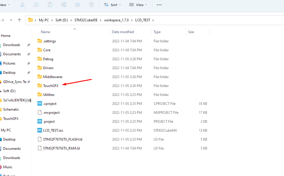

this is my project path

Why is your project put in the workspace folder by the way ? Did you manually set the TouchGFX project generation to this folder ? It would be better to have it elsewhere than in the workspace folder, /D/TouchGFX is fine for example.

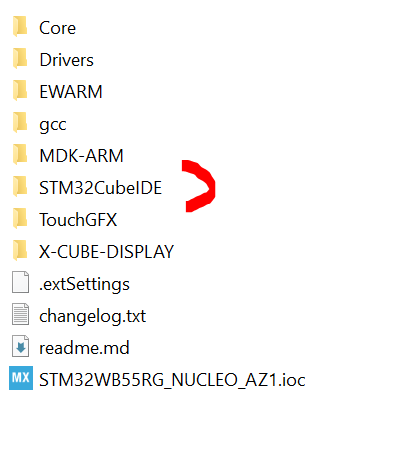

In addition, when you generate a project from TouchGFX Designer with a TouchGFX Board setup for one of ST's development kit, you will see that the project structure is different: the STM32CubeIDE related files and project are under a STM32CubeIDE folder as you can see in the screenshots below. When starting a project from STM32CubeMX we recommend to uncheck the "Generate Under Root" option to keep this project structure, it will ease your development process.
0693W00000WHebTQAT.png/Romain

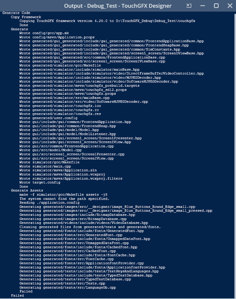

This is my LOG Files. I am using TouchGFX for a Custom Board. so first i am tring to run in TouchGFX simulator. but its also failed.
Can you try to create a new project from STM32CubeMX or just start a project from TouchGFX Designer (but in another folder than the STM32CubeIDE workspace) ? I want to check if once again you are missing the .aplication.config file that is generated in your project's /TouchGFX folder.

Here is Both File. i have created in different folder. in D/TouchGFX_Debug/

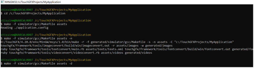

Could you open TouchGFX Environment, change directory to your project root and run make commands, like on this picture :
0693W00000WHjYFQA1.pngPlease let me know which output to you get.

Please find the attach. this is the content after run make command
