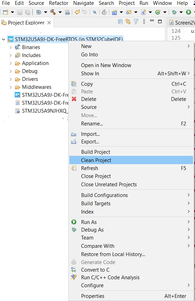

When I have this issue, I try to right-click on my project on STM32CubeIDE and "clean project", it helps sometimes.

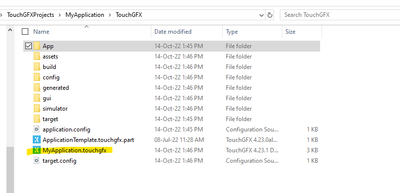

I don't understand where I have to check the presence of the line. I can't find a file named .touchgfx.

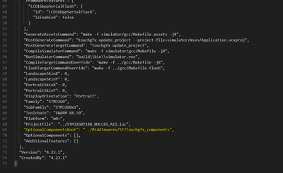

The .touchghfx file is your TouchGFX project file which is generated when you create a project.
If you open it with a text editor, you should have the "OptionalComponentsRoot" line :
Could you check that?
Also, could you try generate code not from STM32CubeIDE but STM32CubeMX instead (and generate code on TouchGFX Designer afterwards)?
‎2024-03-19 1:16 AM
Hello Osman,
Yes I have this line near the end of the file :
"OptionalComponentsRoot": "../Middlewares/ST/touchgfx_components" (copy-paste from my file opened with the text editor)
