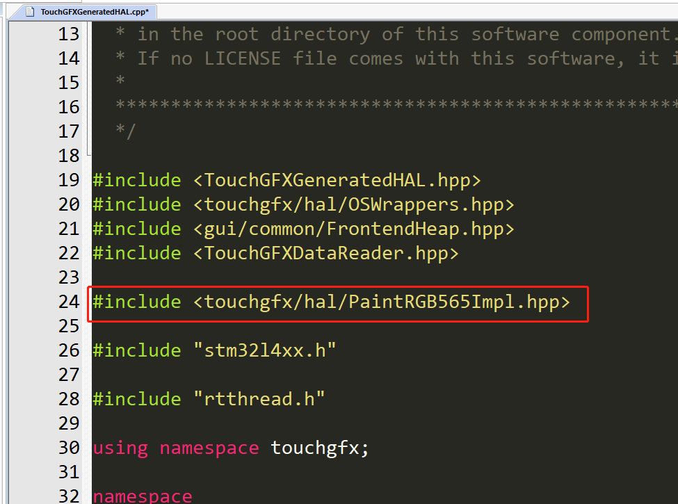

STM32L4R9 + touchgfx4.20 + MDK build error?
zhuij.1
Error: L6218E: Undefined symbol touchgfx::paint::rgb565::lineFromColor(unsigned short*, unsigned, unsigned, unsigned char, unsigned) (referred from painterrgb565.o).
How to resolve?

I've got similar errors while upgrading from 4.19.1:
Error: L6218E: Undefined symbol touchgfx::paint::rgb888::lineFromColor(unsigned char*, unsigned int, unsigned int, unsigned char) (referred from painterrgb888.o).
Error: L6218E: Undefined symbol touchgfx::paint::rgb888::tearDown() (referred from painterrgb888.o).
Error: L6218E: Undefined symbol touchgfx::paint::rgb888::lineFromRGB888(unsigned char*, unsigned char const*, unsigned int, unsigned char) (referred from painterrgb888bitmap.o).
Error: L6218E: Undefined symbol touchgfx::paint::rgb888::lineFromARGB8888(unsigned char*, unsigned int const*, unsigned int, unsigned char) (referred from painterrgb888bitmap.o).
Error: L6218E: Undefined symbol touchgfx::paint::rgb888::lineFromL8RGB888(unsigned char*, unsigned char const*, unsigned int, unsigned char) (referred from painterrgb888l8bitmap.o).
Error: L6218E: Undefined symbol touchgfx::paint::rgb888::lineFromL8ARGB8888(unsigned char*, unsigned char const*, unsigned int, unsigned char) (referred from painterrgb888l8bitmap.o).
Error: L6218E: Undefined symbol touchgfx::paint::rgb888::setL8Pallette(unsigned char const*) (referred from painterrgb888l8bitmap.o).
Including PaintRGB565Impl.hpp, as shown above did not solve an issue - error messages changed to "multple defined symbol" for all those methods.

I did a little walk through TouchGFX and found a reason for the issue.
Someone have put functions definitions (implementations) in header file PaintRGB565Impl.hpp. Don't know anything about coding standards for TouchGFX, but it's not considered good practice in C and C++ (except for templates) and for a reason.
Keil MDK just exposed this issue.
