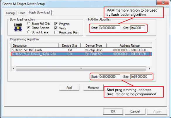

Recently, I build a project with TouchGFX for STM32H743,and the total files are more than 2MB,so I have to use external flash memory(W25Q256).
Then, I am trying to use QSPI interface to connect external memory and execute in interrupt method.
But I have no ideal how to build the function,can any one help me or provide source code?
By the way, I have already added the algorithm about W25Q256,and the other initialize was done , backlight was turned on.
Thanks!

Hi @Andreas Bolsch​ ,
Thanks for your reply!
Do you mean this one in CubeMX?
And I have browsed source code in project,then it was built with TouchGFX but just like the same code what I build .
I didn`t find any function different,Am I find the wrong file?
Thanks!

What do you mean by "But why ..."
I mean that if you want to use QSPI external memory,shouldn`t it need to ad the corresponding algorithm?
Or how can it get the function with,and execute the data from it.
You mean for the initial programming of the firmware into the flash? This 'external loader' has to be supplied by you (as the pin mapping, transfer modes and flash initialization you want to use might not be the same as for the loaders shipped by ST). For this search for 'external loader' here, there are already a number of postings here for this topic.
