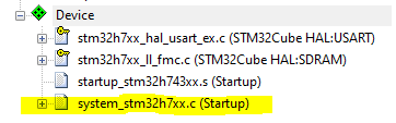

looks like you compiled the file system_stm32h7xx.c twice.
One file is usually provided by Keil (Keil-Packs). You will find it under "Device".
Find and remove the other file.

it helped me a lot
really really thank you
