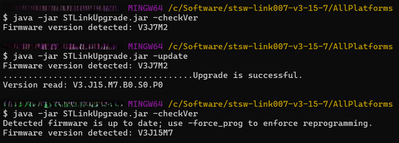

I can see that we can upgrade the st-link firmware for STM32 boards via STM32CubeProgrammer, ST-LINK Utility or STSW-Link007 tool. But I have observed that this will always pick up the latest version which is available. How to update to a specific st-link version?
Also, what is the bare minimum st-link firmware version required for Nucleo-H743 and Nucleo-U575 boards to run twister? Is there a dependency for twister on st-link version? Are the st-link versions backwards compatible?
Above image (for H743) shows how I checked the version and updated it via command line. But this seems to pick up a fixed version. It seems that the versions are linked to the STLinkUpgrade.jar file. Is this correct?

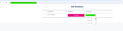

You can download needed version and install :
You can downgrade also with this way

The version of stsw-link007 is the firmware version but without the letters:
As example: stsw-link007 3.9.3 is ST-LINK firmware version V3J9M3

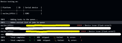

@Mike_ST We upgraded all the H7 boards connected to our agent machines to V3J15M6 version. We are running twister tests on pipeline.
But still, we are getting this error. Locally this error doesn't occur. Any suggestions would be really helpful.
