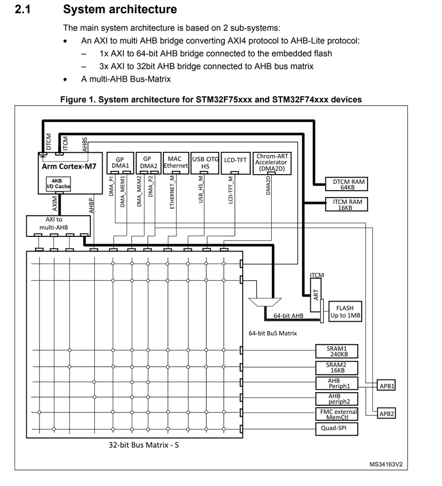

However, with the RAM, I am seemingly on the edge of its capacity, but am also getting confusing information from the datasheet. I would ideally like to have a solution that does not require external RAM (reduce pinout usage).
RAM Calculation (Single Buffer):
480 x 272 x 16 / 8 = 261.120 kBytes
Now, there are two pieces of information in the STM32F756ZG datasheet.
From their circuit diagram:
From Section 2 of their Reference Manual:
If I use the information from the circuit diagram, then it is sufficient. If I use Section 2, then I do not have enough. Because of this, I have two questions:
1) Can I actually use 320 kBytes for the display or 240 kBytes?
2) If 240kBytes, is there a way to reduce the display requirement to get it from 261kBytes to 240 kBytes?
Thank you in advance.

SRAM1 240KB is the only one I think you have clean bus/DMA access too

Your LTDC config can combine L8 graphics. Then required RAM is 480x272 + 256x3
for single full screen framebuffer. Second choice is 256kB / 480 / 2 = 273
Place FB into SRAM1+SRAM2
Normal data place into DTCRAM
