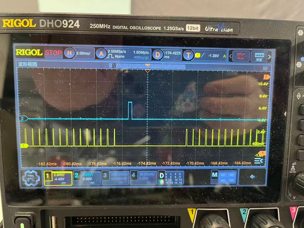

I'm using the STM32H747 DCMI peripheral to capture video from an OV5640 camera, and I've encountered a confusing situation regarding synchronization signal polarity.
Development Environment
  • Board: STM32H747I-DISCO
  • Camera Module: B-CAMS-OMV (OV5640)
  • Firmware: Official example project
    STM32CubeH7/Projects/STM32H747I-DISCO/Examples/DCMI/DCMI_CaptureMode/CM7/Src/main.c
OV5640 Configuration
In the OV5640 register 0x4740 (POLARITY CTRL00), I configure:
{OV5640_POLARITY_CTRL, 0x22}
According to the datasheet, this means:
  • Bit[5] = 1 → PCLK polarity: Active high
  • Bit[1] = 1 → HREF polarity: Active high
  • Bit[0] = 0 → VSYNC polarity: Active low
So the camera outputs:
  • HREF high during valid line data
  • VSYNC low during valid frame data
  • PCLK rising edge for pixel sampling
STM32 DCMI Configuration
In the STM32H747 DCMI_CR register, I configure:
DCMI->CR |= (1 << 7) | (1 << 6); // VSPOL = 1, HSPOL = 1
According to the STM32 reference manual:
  • VSPOL = 1 → VSYNC high = invalid frame
  • HSPOL = 1 → HSYNC high = invalid line
This implies:
  • VSYNC low = valid frame → matches OV5640 :white_heavy_check_mark:
  • HSYNC low = valid line → contradicts OV5640 HREF high
:question_mark: The Confusion
I connect OV5640's HREF signal to STM32's DCMI_HSYNC pin. According to the polarity settings:
  • OV5640 outputs HREF high during valid line
  • STM32 expects HSYNC low during valid line (HSPOL = 1)
This seems mismatched. Yet surprisingly:
  • Image capture works perfectly with this configuration
  • If I change HSPOL to 0 (i.e. HSYNC low = invalid), capture fails
What I Need Help With
  • Why does this polarity mismatch still result in correct image capture?
  • Are there known quirks or undocumented behaviors in DCMI signal handling?

Hi,@KDJEM.1 Thank you for your reply. Below are my clarifications:
When I set the OV5640 register 0x4740 to 0x20 (default value), the output VSYNC (blue) and HSYNC (yellow) signals behave as follows: From the captured waveform, it is evident that VSYNC is high when data is invalid and low when data is valid; similarly, HSYNC is also high when data is invalid and low when data is valid. This matches the description of register 0x4740 in the OV5640 datasheet.
On the other hand, in the STM32 DCMI configuration, HSPOL and VSPOL indicate the signal level on the DCMI_HSYNC and DCMI_VSYNC pins respectively when parallel data is invalid. Based on the oscilloscope results, I should configure HSPOL = 1 and VSPOL = 1 to match the observed behavior. However, with this configuration the camera data cannot be captured correctly. In practice, I need to set HSPOL = 0 and VSPOL = 1 in order to successfully receive valid data from the OV5640.
fengxun2017AuthorBest answer
January 12, 2026
I've found the reason. Based on the output image size and PCLK clock, I can calculate the time required to output valid data, thus deducing that the high level period of HSYNC in the above image is the valid data output phase of the OV5640. The OV5640 manual description is unclear.
