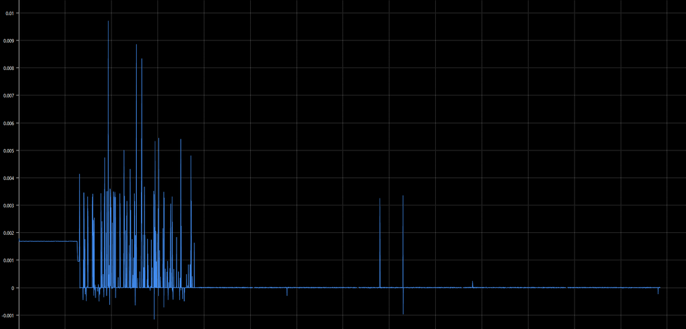

I have been exploring your example “BLE_HeartRateThreadX”, which provides a good base for what I am trying to achieve. From my analysis, the example initially runs a 60-second fast advertising phase, with intervals of 20–30 ms, which results in higher current consumption. After this period, it transitions to a low-power advertising mode with intervals of 1–2.5 seconds.
From what I understand, low-power management is handled automatically by the RTOS together with the LPM module. The Idle task appears to be responsible for placing the system into low-power mode and setting the Link Layer into deep sleep. The Timer Server API then uses the RTC as a wake-up source whenever the radio needs to transmit a BLE packet. Based on the configuration, it seems the application automatically determines whether there is a sufficient time window to put the MCU into sleep before the next transmission.
Could you please confirm if this understanding is correct?
Using this example, I measured the current consumption following the method described in the first post. According to the datasheet, this method powers only the MCU, meaning that all additional hardware on the development kit (such as LEDs, ST-Link, etc.) is disabled. I configured the low-power mode to the maximum level (level 2, i.e., standby) and disabled debug/logging features to minimize consumption.
I have attached a photo of the results. During the fast advertising phase, there are visible current peaks. When the system transitions to low-power advertising, the current drops to around 15 µA, which is very close to the datasheet specification for BLE advertising in standby mode. However, even in this mode I get random peaks, what are they?

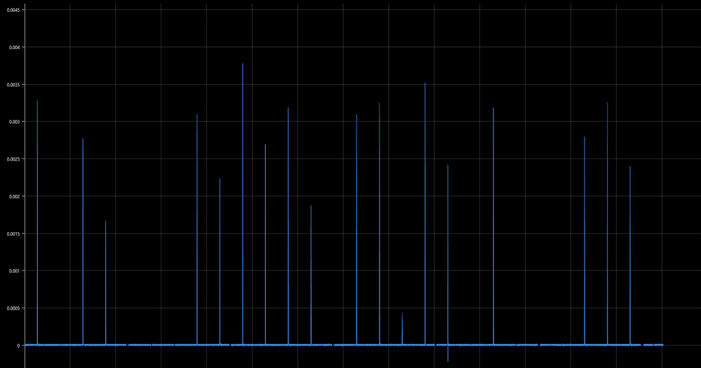

Based on this example, I developed my own application following the same principles. However, in my case, I use low-power advertising continuously. Therefore, I expected to observe a relatively constant current around 15 µA, without significant peaks.
However, as shown in the attached images, there are multiple current spikes that I do not fully understand. Could these spikes correspond to BLE packet transmissions? Some of them seem to be separated by 2.5 second what would make sense, but this beahviour is not constant. If so, why does this not happen in the original example?

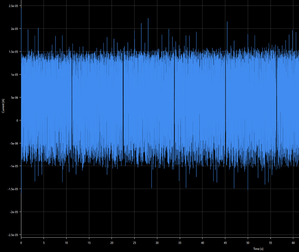

Hello, quick update, I have removed the line that starts the advertise from my code and the mean consumption should be around 7uA. So I'm guessing the spikes are related to the BLE advertise.
