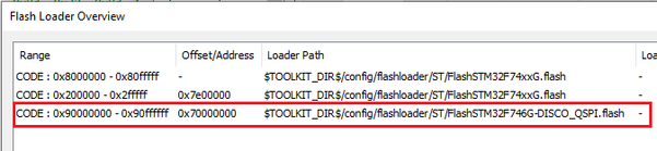

TouchGFX V6.22.0. I generated the project in TouchGFX for IAR. TouchGFX locate the backgrounds and widgets in external flash memory. The Discovery STM32F746 board has MT25QL128ABA1EW9 memory.
In IAR I select "Use Flash Bootloader"
Select STM32F746G-DISCO_QSPI.flash
When I press the button "Download and Debug"
I have the next information in the log:
Wed Oct 16, 2024 21:00:42: Hardware reset with strategy 0 was performed
Wed Oct 16, 2024 21:00:42: Verification error at 0x9000'0000: mem = 0x00, file = 0x0B
Wed Oct 16, 2024 21:00:42: Download completed but verification failed.
Wed Oct 16, 2024 21:00:42: Target reset
Wed Oct 16, 2024 21:00:42: There were 1 error and 1 warning during the initialization of the debugging session.

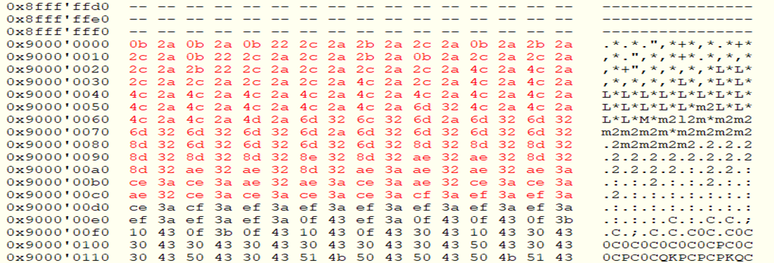

Memory window in the IAR
Part of the array where it is stored backgrounds image
LOCATION_PRAGMA("ExtFlashSection")
KEEP extern const unsigned char image_alternate_theme_images_backgrounds_480x272_gradient_dark[] LOCATION_ATTRIBUTE("ExtFlashSection") = { // 480x272 RGB565 pixels.
0x0b, 0x2a, 0x0b, 0x2a, 0x0b, 0x22, 0x2c, 0x2a, 0x2b, 0x2a, 0x2c, 0x2a, 0x0b, 0x2a, 0x2b, 0x2a,
0x2c, 0x2a, 0x0b, 0x22, 0x2c, 0x2a, 0x2c, 0x2a, 0x2b, 0x2a, 0x0b, 0x2a, 0x2c, 0x2a, 0x2c, 0x2a,
0x2c, 0x2a, 0x2b, 0x22, 0x2c, 0x2a, 0x2c, 0x2a, 0x2c, 0x2a, 0x2c, 0x2a, 0x4c, 0x2a, 0x4c, 0x2a,
0x2c, 0x2a, 0x2c, 0x2a, 0x2c, 0x2a, 0x2c, 0x2a, 0x4c, 0x2a, 0x2c, 0x2a, 0x4c, 0x2a, 0x4c, 0x2a,
0x4c, 0x2a, 0x4c, 0x2a, 0x4c, 0x2a, 0x4c, 0x2a, 0x4c, 0x2a, 0x4c, 0x2a, 0x4c, 0x2a, 0x4c, 0x2a,
0x4c, 0x2a, 0x4c, 0x2a, 0x4c, 0x2a, 0x4c, 0x2a, 0x4c, 0x2a, 0x6d, 0x32, 0x4c, 0x2a, 0x4c, 0x2a,
0x4c, 0x2a, 0x4c, 0x2a, 0x4d, 0x2a, 0x6d, 0x32, 0x6c, 0x32, 0x6d, 0x2a, 0x6d, 0x32, 0x6d, 0x32,
1) I can't understand what the file = 0x0B means in the following error?
2) Where can I find this file?
3) I don't understand why there is a verification error? Where did I make a mistake? Perhaps additional settings need to be made? I would be very grateful for any help and ideas.

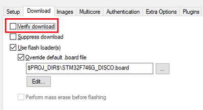

Today I did the following experiment. Using IAR Embedded Workbench, I loaded firmware into the STM32F746 Discovery board.
Then I read the contents of the external flash memory using the SMT32CubeProgrammer and compared the read values with the hex file generated by IAR. These values completely matched. From this I conclude that the verification error is related to a flaw on the IAR side.
So far I have not found a way to fix this error and simply disabled the verification option as shown below.
I really hope that the company ST Microelectronics, in cooperation with IAR, will correct this error soon.
If anyone has encountered a similar problem, please write. I wonder how you solved this problem.
Thanks!

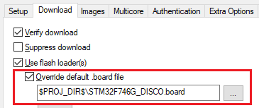

I am using the FlashSTM32F746G-DISCO_QSPI.mac file.
I checked the pin assignments on the debug board against the .mac file. Everything is correct there.
Then I compared the files: EWARM_v7_ValueLine_STM32F7x0x8_Supportv4.0\arm\config\flashloader\ST\FlashSTM32F7xx_QSPI_STM32F7508-DISCO.mac and FlashSTM32F746G-DISCO_QSPI.mac
The only difference is that in the FlashSTM32F746G-DISCO_QSPI.mac file the /* Enable and Reset QSPI */ section is at the end of the file, while in the FlashSTM32F7xx_QSPI_STM32F7508-DISCO.mac file it is at the beginning.
I put the /* Enable and Reset QSPI */ section at the beginning of the FlashSTM32F746G-DISCO_QSPI.mac file, but it did not affect the operation.
I also have a STM32F7508-DK debug board.
I patched the IAR files in the directories:
debuger
devices
flashloader
linker
from the zip archive: STM32Cube_FW_F7_V1.17.1\Utilities\PC_Software\patch\EWARM\EWARM_v7_ValueLine_STM32F7x0x8_Support.zip
When loading the project in the STM32F7508-DK, the same verification error occurs as for the STM32F746-DK.
