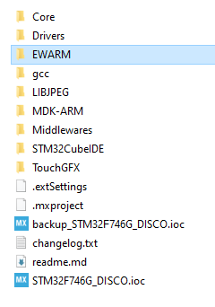

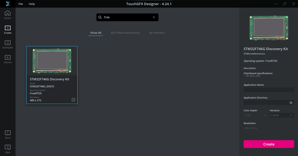

Hello @Alex_777,
TouchGFX supports IAR Embedded Workbench, and if you use the provided TouchGFX Board Setup (TBS) for the STM32F746G Discovery Kit, then you can open the STM32CubeMX project (.ioc file), and change the Toolchain/IDE from the "Project Manager" tab to EWARM, and press generate code. Then, from your TouchGFX project, you have generate code as well. By navigating to the EWRAM folder in your project's directory, you can access the IAR project. The required settings are already provided; therefore, you don't need to change anything.
TBS for STM32F746G Discovery Kit
EWARM directory
If you still have trouble downloading the program to your board, you can compile the program by IAR, and use the outputted .hex file to download on your board with STM32CubeProgrammer. You can read more about this process here.

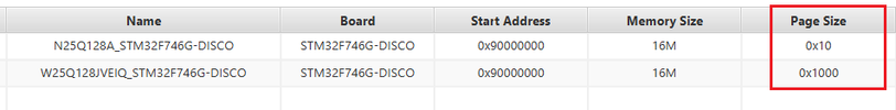

As for the program STM32CubeProgrammer, it does not support the memory MT25QL128, you need to create the .stldr file manually.
Memory chips N25Q128A and W25Q128J has the same page size - 256 bytes.
Why do we see different page sizes in STM32CubeProgrammer?

The N25Q128 is just a much earlier variant of the Micron part, perhaps with an older die, when ST/Micron were fab partners. I'd imagine the newer parts have shrunk die to increase wafer yield as part of Micron's longevity model, which is form-fit-function not making the same die for decades, allowing them to pivot into new tighter geometries as fab tech advances.
Similarly the page size of both the Micron and Winbond are 256 bytes. The loader does the deblocking internal when given a large buffer. Cube Programmer uses this value as a guide to how to align Write() requests on a address and size basis.
The Winbond and Micron have slightly different architecture, and management of status registers and mode.
Old and new Micron parts are subtly different but shouldn't cause failure. Some issue with IAR's script here
