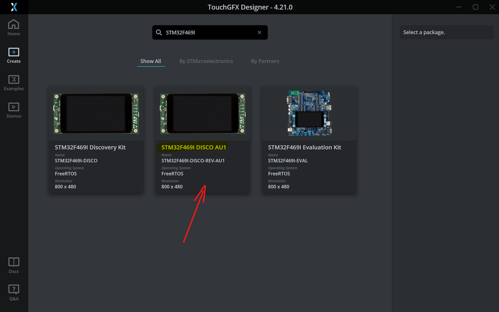

Hello LDini.1,
A new TBS is now available on TouchGFX Designer 4.21.0 for this STM32F469I-Disco $AU1 revision (B08)
It should resolve the issue with the black screen.
/Osman
