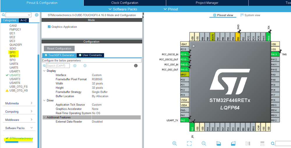

I have STM32F446RE and X-Nucleo-GFX01M1.
When flash my nucleo I get:
File download complete
Time elapsed during download operation: 00:00:03.366
Verifying ...
Download verified successfully
Debugger connection lost.
Shutting down...
But I cannot see anything on my screen.
Probably because when I generate the code, the SW does not modify the SPI configuration and not initialize it.
reading the following document https://www.st.com/resource/en/user_manual/dm00720406-.pdf
for me, it is not clear how should I do it. Ex: mode: full/half duplex? CPL/CPA ? CRC calculation? LED? FMARK? etc.
Thanks
Fausto

‎2021-06-30 7:13 AM
Debug conection lost exist when in code you use GPIO pin SWDIO SWDCLK or sleep stop standby mode and dont setup debuger for it, or when your MCU start app and this result to error for example hardfault...
‎2021-06-30 7:35 AM
ok, but the display is still white :)
‎2021-06-30 7:55 AM
Then some other issue, then.
Perhaps try some other code, and port that, perhaps looking at the settings/configuration used there.
‎2021-06-30 8:01 AM
X-CUBE-DISPLAY_1_0_0\Projects\NUCLEO-G071RB\Applications\GFX01M1_HelloWorld\Core\Src\stm32g0xx_nucleo_bus.c
