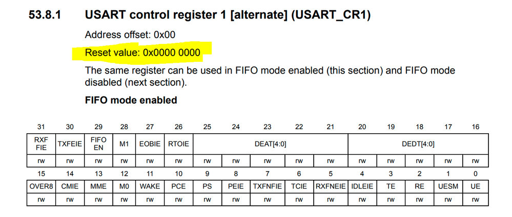

The reference manual I was using is RM045, and I don't see the reset register values... for example, Section 53.8.1 on page 2004 details USART_CR1 (FIFO-enabled), but I don't see the reset values there... am I looking in the right place? I remember also looking in that general section and not finding it.

> RM045
You mean RM0455?
https://www.st.com/resource/en/reference_manual/dm00463927-stm32h7a37b3-and-stm32h7b0-value-line-advanced-armbased-32bit-mcus-stmicroelectronics.pdf
It's at the start of each register. "Reset value"
