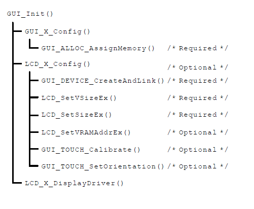

Hi guys, I'm using STM32CubeMx V4.26 to configure STM32F429 that is connected to TFT LCD. I m trying to get my TFTLCD to work with StemWin using FreeRTOS. My program compile and link smoothly without problem. Running the program in the hardware leads to an MCU stuck in the function : GUI_init()
I ve checked some similar issues and it looks to be related to the graphic library and RCC clock.
Could any one have guidance for this issue ? are there some sample code ?

‎2018-06-12 8:42 AM
I've tried all the solutions above but none is working, my
LCD_Initialization();
' is working correctly and getting the right data from the lcd. but still the GUI_INIT not responding, also no interrupt is fired!

‎2018-06-12 12:42 PM
set breakpoint at the function
GUI_ALLOC_AssignMemory
GUI_DEVICE_CreateAndLink....
You can determine the function on which the program hangs
P.S. Bug in CubeMX
‎2018-06-14 12:50 AM
emWin Init needs the CRC module enabling as it does a CRC Check on memory - this caught me out once!
Check the CRC Module is clocked and enabled, my STM Code look like this;
/** @note The emWIN GUI_Init() uses the CRC Module to perform a memory
* check - so the CRC clock must be enabled before calling GUI_Init. */ __HAL_RCC_CRC_CLK_ENABLE(); /* Enable the CRC Module */David.

‎2018-06-14 8:45 AM
CubeMX is set CRC module if use GRAPHICS module
