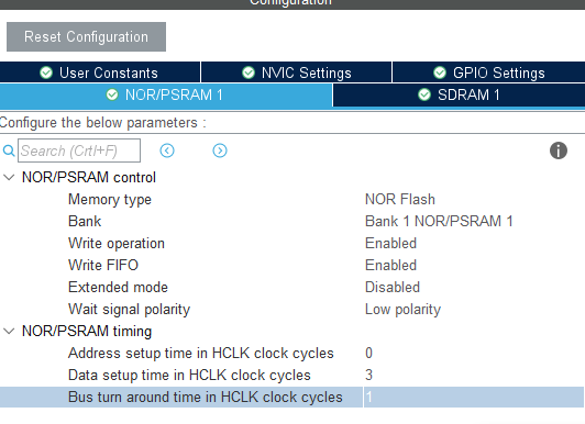

When I use stm32cubemx to configure FMC Nor Flash, I can only configure Timing with Address setup time in HCLK clock cycles/Data setup time in HCLK clock cycles and Bus turn around time in HCLK clock cycles, but I think it should have more settings to configure, like BusTurnAroundDuration and CLKDivision and so on0693W00000AO4aaQAD.bmp

the settings in the STM32CubeMX try closely related to register setting of the MCU. The setting for the individual peripheral try to follow the structure of peripheral registers. For example the BusTurnAroundDuration would be depending on the HCLK frequency and so you define it in terms of HCLK clock cycles. All the configuration for the internal clocks could be found in the specified tab Clock Configuration. Let me know what other parameters you would like to edit maybe I can further help you.

in order to explain my confuse directly, I upload the project I used.
I don't know how to change below code in stm32cubemx project
Timing.CLKDivision = 16;
Timing.AccessMode = FMC_ACCESS_MODE_A;
where can I change CLKDivision and AccessMode?

thank you for sending the .ioc file. It made it easier to find what could be wrong. I must clarify, that I my knowledge about FMC is bit limited. But I contacted my colleague and he pointed me in the right direction. Anyway the reason you cannot see setting for CLKDivision and AccessMode is due to current setting for the FMC.
If you would like to use CLK output it is currently blocked by DCMI peripheral. In case you disable it and reset the pins, then you can select clock - burst read option together with address valid option. Then you can found CLK clock divide ration in NOR/PSRAM timing settings.
To solve the problems with selecting access mode is easier. You just need to set extended mode to Enabled and then you are able to set the access mode. I just would like to point out that the extended mode are available only when using asynchronous transactions.

I tried what you said, you are correct. This solved a lot of my doubts
