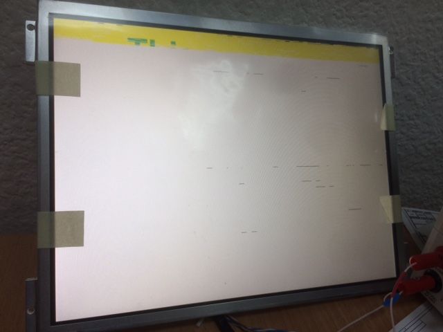

Recently I was faced with a problem using GUI_GIF_Draw() function. That function works properly with a graphical memory assigned to internal RAM using GUI_ALLOC_AssignMemory() and fails if memory assigned to SDRAM.
My chip is STM32F777ZI.
SDRAM is
MT48LC32M16A2
.My old thread:
https://community.st.com/0D50X00009XkWIZSA3
I suggest my problem is that MPU not properly configured for SDRAM regions. In LTDC manual (AN4861) there is a chapter with special recommendations for Cortex-M7 at page 81. This chapter containing an information about MPU regions configuration.
I created following regions:
Region0: defines the whole SDRAM memory (64 MByte in my case);
(graphical memory (aMemory) assigned to STemWin using
GUI_ALLOC_AssignMemory() (&sharpdefine GUI_NUMBYTES 0x2000000) and allocated at lower 32 Mbyte of SDRAM. It has a start address 0xC000000 as SDRAM connected through FMC Bank1);
Region1: defines the framebuffer memory (&sharpdefine LCD_LAYER0_FRAME_BUFFER ((uint32_t)0xC2000000)); upper 32 Mbyte of SDRAM;

Got an error.
status = 1:

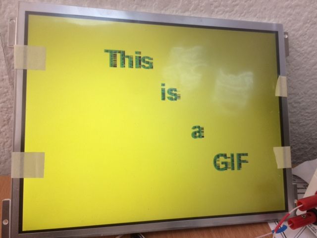

Next I reconfigured regions to WBWA:
void MPU_Config(void)
LL_MPU_Disable();
LL_MPU_ConfigRegion(LL_MPU_REGION_NUMBER0, 0x0, 0xC0000000, LL_MPU_TEX_LEVEL1|LL_MPU_REGION_SIZE_64MB|LL_MPU_REGION_FULL_ACCESS|
LL_MPU_INSTRUCTION_ACCESS_ENABLE|LL_MPU_ACCESS_NOT_SHAREABLE|
LL_MPU_ACCESS_CACHEABLE|LL_MPU_ACCESS_BUFFERABLE);
LL_MPU_EnableRegion(LL_MPU_REGION_NUMBER0);
LL_MPU_ConfigRegion(LL_MPU_REGION_NUMBER1, 0x0, 0xC2000000, LL_MPU_TEX_LEVEL1|LL_MPU_REGION_SIZE_32MB|LL_MPU_REGION_FULL_ACCESS|
LL_MPU_INSTRUCTION_ACCESS_DISABLE|LL_MPU_ACCESS_NOT_SHAREABLE|
LL_MPU_EnableRegion(LL_MPU_REGION_NUMBER1);
LL_MPU_Enable(LL_MPU_CTRL_PRIVILEGED_DEFAULT);
And got this one. status = 0. No errors but the GIF contains distortion artifacts:

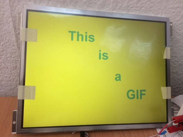

And again I reassigned aMemory for STemWin to internal RAM and got a fine picture. status = 0:
Seems that MPU regions not properly configured in case of aMemory allocation in SDRAM.

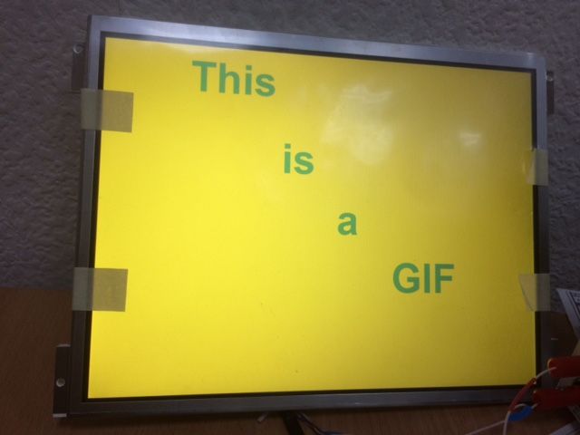

I havemanagedGUI_GIF_Draw()to work properly with memory pool for STemWin assigned to SDRAM but still have a problem with drawing the same GIF using IMAGE_SetGIF() on IMAGE widget when using WM.
GUI_GIF_Draw()now works with the following configuration of the MPU:
{LL_MPU_Disable();
LL_MPU_ConfigRegion(LL_MPU_REGION_NUMBER0, 0x0, 0xC0000000, LL_MPU_TEX_LEVEL1|LL_MPU_REGION_SIZE_32MB|LL_MPU_REGION_FULL_ACCESS|LL_MPU_INSTRUCTION_ACCESS_ENABLE|LL_MPU_ACCESS_NOT_SHAREABLE|LL_MPU_ACCESS_CACHEABLE|LL_MPU_ACCESS_BUFFERABLE);
LL_MPU_ConfigRegion(LL_MPU_REGION_NUMBER1, 0x0, 0xC2000000, LL_MPU_TEX_LEVEL1|LL_MPU_REGION_SIZE_32MB|LL_MPU_REGION_FULL_ACCESS|LL_MPU_INSTRUCTION_ACCESS_DISABLE|LL_MPU_ACCESS_NOT_SHAREABLE|LL_MPU_ACCESS_CACHEABLE|LL_MPU_ACCESS_NOT_BUFFERABLE);LL_MPU_EnableRegion(LL_MPU_REGION_NUMBER1);
LL_MPU_Enable(LL_MPU_CTRL_PRIVILEGED_DEFAULT);}
That's on the LCD:

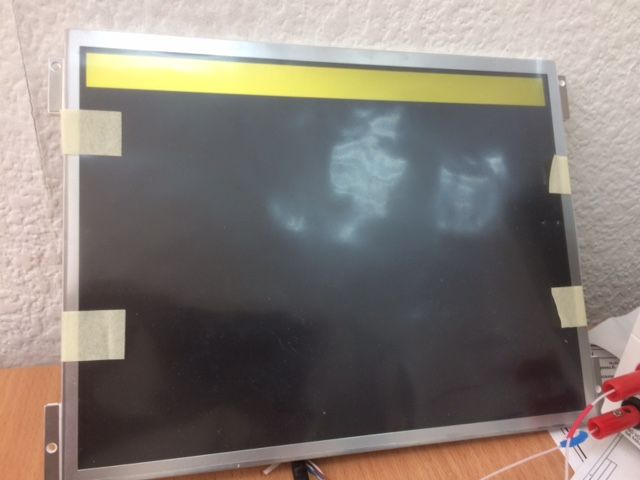

Next I began to use Window Manager. Icreated a simple window usingGUIBuilder (WINDOW widget 1024x768) with a child IMAGE widget (1024x768) on it and assigned my GIF file to this IMAGE widget. GUIBuilder then generated a simple corresponding code (in the attached *.zip archive) with IMAGE_SetGIF()to assign the GIF. Without enabling Memory Devices (using WM_SetCreateFlags(WM_CF_MEMDEV)) all works fine (the same picture as on the photo above), but when usingWM_SetCreateFlags(WM_CF_MEMDEV)I've got an error again:
I even implemented useless ''GetData()'' function to read data from the GIF-array just to reduce the memory usage and check the function IMAGE_SetGIFEx()(instead ofIMAGE_SetGIF()). As a result I've got the same error.
