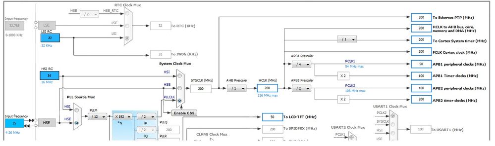

I've also read the LTDC manual from ST (AN4861) attentively and configured all the recommendations that described in this manual (SDRAM and LTDC clock restrictions and MPU regions configuration on SDRAM and internal RAM). SDRAM clock is 100 MHz, and LTDC clock is 50 MHz.

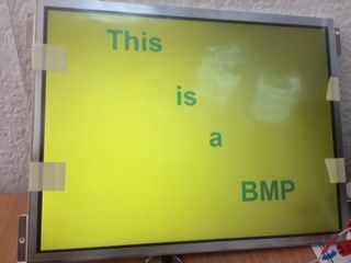

After that I made a simple 1024x768 BMP picture in GIMP (Green text "This is a BMP" on the yellow background), then I optimized it using Bitmap Converter, then converted it to C-array using Bin2C for GUI_BMP_Draw() function and finally got it on the screen:

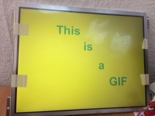

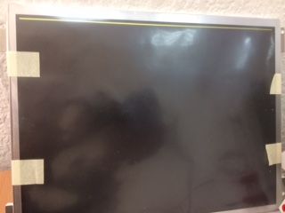

0690X00000604TvQAI.jpgNext I made a same GIF picture ("This is a GIF"), unoptimized it as described in emWin manual (exactly in emWin UM03001, not in StemWin manual StemWin532.pdf) then again used Bitmap Converter and converted the GIF to C-array for using with GUI_GIF_Draw().
And got this one:
0690X00000604C1QAI.jpgSeems that only few first lines of the GIF displayed. GUI_GIF_Draw() returned 1. That is error.

GUI_GIF_Draw() returned 0. Works fine.
Can anyone suggest what is wrong with the drawing a GIF with aMemory allocated in SDRAM? First I thought that problem is in SDRAM, but GUI_BMP_Draw() and GUI_DrawBitmap() work properly regardless of aMemory allocation. May be I missed some options when I configured STemWin? Or while configurating peripherals (DMA2D, FMC, MPU regions...)?

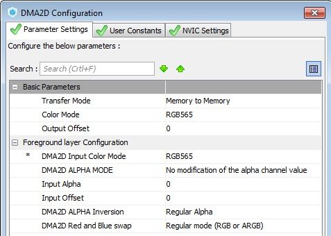

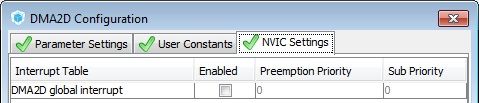

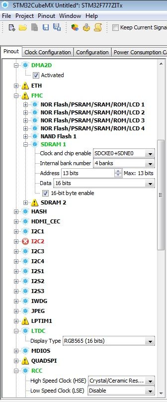

Some configuration screens from STM32CUBEMX.
Pinout:
DMA2D:

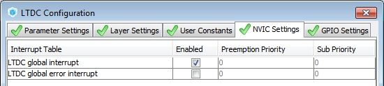

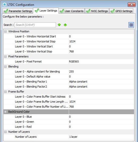

LTDC:
0690X00000604b0QAA.jpg0690X00000604kqQAA.jpgColor frame buffer start address for Layer 0 reassigned to 0xC0400000 in LDC_X_Config()

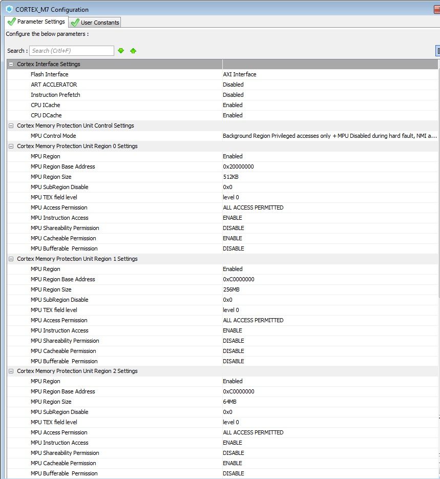

MPU:
0690X00000604JSQAY.jpgSDRAM:

It seems that problem is in MPU regions configuration as I'm using STM32F777ZI chip.
AN4861 contains recommendations how to configure the MPU regions in case of graphical memory allocation in SDRAM.
AN4838, AN4839 contains recommendations how to configure the MPU regions as such.
Cortex-M7 has a complex system to handle access to the memory regions. And I'm currently having a hard time configurating the MPU regions for SDRAM space.
