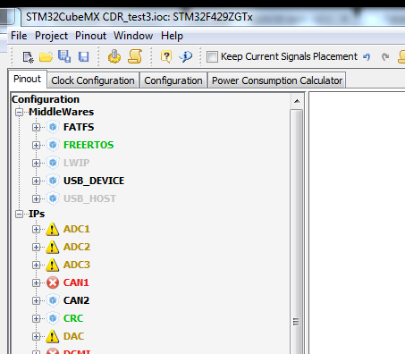

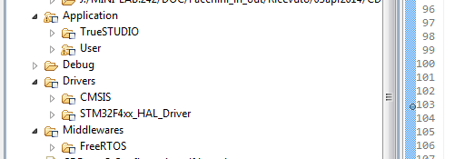

and when I generate source code for Atollic TrueSTUDIO I cannot find the STemWin path in the project.
So, what's the correct way to easily include into a project generated from CubeMX the STemWin libraries?Thanks,Stefano Tilli #stemwin #atollic #st32cubemx
Dear all,
I'm a satisfied user of the new STM32CubeMX software. I'm currently using the last version: v.4.1.0 with the latest libraries/firmware package (v.1.1.0).In every guide I read I found out that in the middleware section CubeMX should integrate: Networking, USB, FATFS, RTOS and STemWin graphics.In the left panel of the software I cannot see the STemWin section (as shown in the picture).

Hello Stefano,
STM32Cube embedded software packages include such middleware libraries, but they are not all supported by STM32CubeMX code generation yet: only FATFS, FreeRTOS, USB and LwIP are. For other libraries, you will need to manually copy them into your project.
