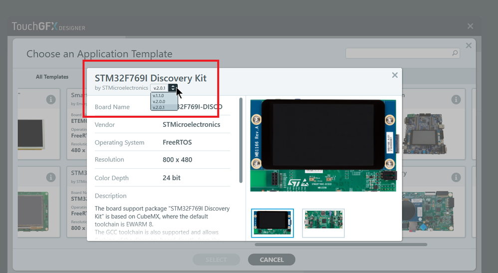

If you select V2.0.0 of the STM32F769-DISCO application template from the designer you should be able to program your board.
That article you're linking to exists to compensate for errors in CubeMX generation. I will remove it soon because as CubeMX improves TouchGFX code and project generation these articles lose their purpose.
The work has already been done for you in the F769-DISCO application template.

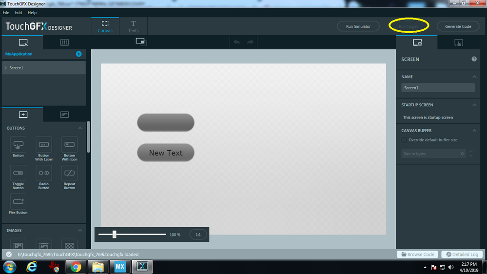

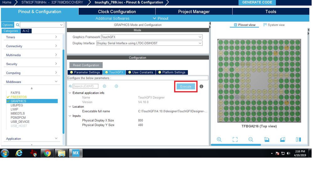

I am configuring the STM32F769I discovery Board in CubeMX and then use 'Execute' to generate the TouchGFXdesigner application.
But I think , TouchGFX doesn't maps the target correctly from CubeMX as the 'Run Target' option is inactive. (highlighted in yellow) Though it generates code without an error.

This option to select the application template is available when I start creating my project in TouchGFX. But when I start in CubeMX and 'Execute' it from CubeMX, The TouchGFX designer automatically opens up but there is no option available to choose the application template from this route.
