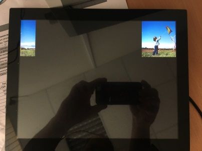

I'm working on displaying JPEG files using STM32H745BIT6 chip.
I successfully configured all peripherals (LTDC, DMA2D, HW JPEG decoder) and now I'm able to dislay JPEG data. At first JPEG decoder converts JPEG data to YCbCr data and then DMA2D converts that data to RGB and transmits it to the screen (1024x768).
Here's part of the code:
// JPEG HW decoding
JPEG_Decode(&hjpeg, (uint32_t)image_320_240_jpg, IMAGE_320_240_JPG_SIZE , (uint32_t)JPEG_OUTPUT_DATA_BUFFER);
// Waiting for the end of decoding
 while(Jpeg_HWDecodingEnd == 0);
// Getting JPEG data
 HAL_JPEG_GetInfo(&hjpeg, &JPEG_Info);
// Set the org of the image
 xPos = 0;
 yPos = 0;
// Send the image using DMA2D
 DMA2D_CopyBufferJPEG((uint32_t *)JPEG_OUTPUT_DATA_BUFFER, (uint32_t *)0xC2000000, xPos, yPos, JPEG_Info.ImageWidth, JPEG_Info.ImageHeight, JPEG_Info.ChromaSubsampling);

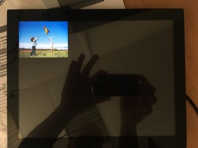

Here's the screen:
The only problem is when X-coordinate of the image makes it to be out of the screen area, the "outer" part of the image is showing at the begining of the screen.
For example, if xPos == 800 then the screen is:
How to avoid this "tail drawing"?
I guess something is missing in DMA2D transfer function.

What am I doing wrong?
Thanks for your attention.

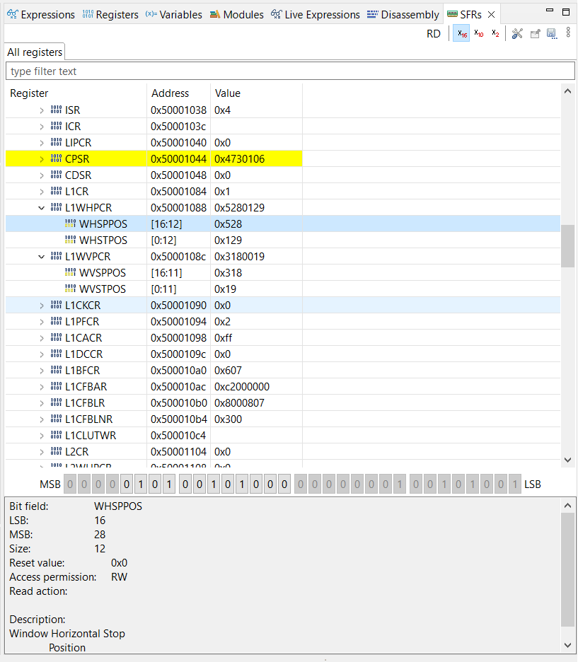

Seems that Window Horizontal Stop is equal to 1024. But, somehow, the problem still exists...
The value in Layer1 WHSPPOS register is 1320 including horizontal back porch value.
_legacyfs_online_stmicro_images_0693W00000bkpUbQAI.pngMaybe this is the reason...

For example if the LTDC_BPCR register is configured to 0x000E0005 (AHBP[11:0] is 0xE) and the LTDC_AWCR register is configured to 0x028E01E5 (AAW[11:0] is 0x28E). To configure the horizontal position of a window size of 630x460, with horizontal start offset of 5 pixels in the active data area:
1. layer window first pixel, WHSTPOS[11:0], must be programmed to 0x14 (0xE+1+0x5)
2. layer window last pixel, WHSPPOS[11:0], must be programmed to 0x28A.

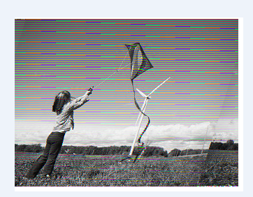

Have you finished the jpeg decode and DMA2D project yet? I am working about them. I have a problem about using JPEG decode and DMA2D. You can fix for me, thanks?
Below is the process I follow:
Step 1: Convert Hex data of Image JPEG from file.h from flash memory
JPEG_Decode_DMA(&hjpeg, (uint32_t)image_320_240_jpg, IMAGE_320_240_JPG_SIZE , JPEG_OUTPUT_DATA_BUFFER);
while(Jpeg_HWDecodingEnd == 0){
Step 2: Use DMA2D convert YCBCR to RGB888
DMA2D_CopyBuffer((uint32_t *)JPEG_OUTPUT_DATA_BUFFER, (uint32_t *)LCD_FRAME_BUFFER, JPEG_Info.ImageWidth, JPEG_Info.ImageHeight);
while(Flag_Dma2d_complete==0){
Step 3: Send data of LCD_FRAME_BUFFER to computer by USART
unsigned char *p;
p = (unsigned char*)LCD_FRAME_BUFFER;
for(i=0; i<(JPEG_Info.ImageWidth*JPEG_Info.ImageHeight*3); i++)
HAL_UART_Transmit(&huart1, p+i, 1024, 5000);
i += 1024;
IWDG_ReloadCounter();
Step 4: Convert data give from USART to image rgb888 on QT5 tool and show on label and Image I have then:
I don't know where is wrong, color of image false, all image as gray.
