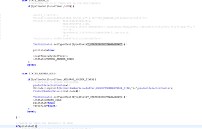

Hi friends, I have this problem:
static uint16_t txt[10];
Unicode::snprintfFloat(txt,6U,"%0.2f",functionGetFloat());
Unicode::snprintf( TextIndicatorBuffer,TEXTINDICATOR_SIZE,"%s %s",TypedText(T_STATEPRODUCTMANAGERWC5).getText(),txt);
TextIndicator.setWildcard(TextIndicatorBuffer);
TextIndicator.invalidate();
this work only once, after calling this function the second once, nothing change... some hint? thanks..

Okey,i think you must have
since in some machine states use setTypedText funtion. Place this setWildcard in the states you use wildcard buffer.

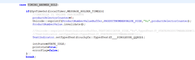

If you use setTypedText()- function in some machine state, you must return it also to the original single use id. Like this:
TextIndicator.setTypedText(touchgfx::TypedText(T___SINGLEUSE_IGD9));
Open your view-base.cpp and check singleuse ID there.
Maybe easier is to not use setTypedText, but do like this
Unicode::snprintf( TextIndicatorBuffer,TEXTINDICATOR_SIZE,"%s",TypedText(T_STATEPRODUCTMANAGERWC1).getText());
in the TIMING_ANSWER_HOLD, then the correct single-use ID stays.
Dear JTP1, I tried to change all lines in snprintf not using TextIndicator.setTypedText(blabla)... not work nothing at all! seems that if I use for this wildcard snprintf, after work once, it not will work over on this buffer.
if you look at the TIMING_ANSWER_HOLD, you can see the same for productSelectorCounter... and this work...
It work onli the first called routine in this sequence... after stop .

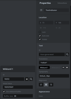

I think it should work just fine. Here is my working example:
float f=0.21;
float  Screen1View::functionGetFloat()
	f+=.15;
	return(f);
void Screen1View::testButtonClicked()
	//TextIndicator.setWildcard(TextIndicatorBuffer);
	TextIndicator.resizeToCurrentText();
void Screen1View::testbutton2Clicked()
	TextIndicator.setTypedText(TypedText(T_TEST));

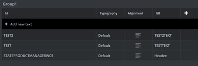

Texts:
textarea settings:
Depending on your text lenghts, you might need to invalidate text area also before change content. (if new is shorter than old, and you are changing the ID from typed ID to wildcard ID).
