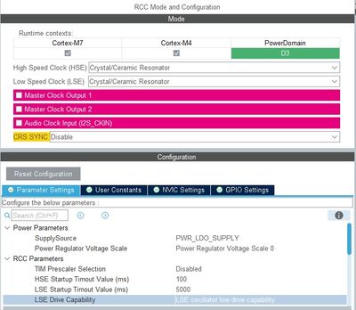

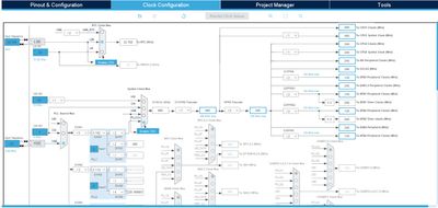

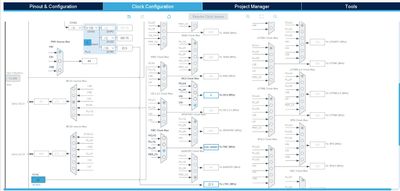

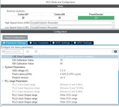

This is my clock configuration:
And this is my RCC settings:
On my board I use this crystal: https://www.ndk.com/images/products/catalog/c_NX2016SA_e.pdf and it is the 25MHz model.
How can I check if the pll is working properly?
