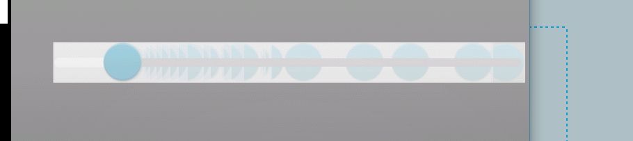

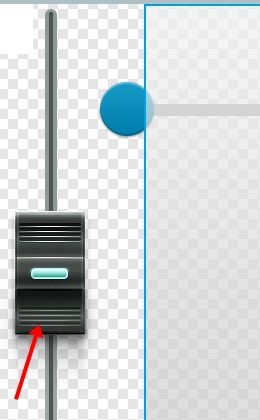

I have made a custom slider , vertical , using pngs .
When I run the simulator it does not appear .
The default Slider shows but weird refresh and leaves a trail ?
Also , is there a way to say which item is on top of the other ? Bring to front , send to back ?
Martin KJELDSEN
Chief III
You're missing a background. What you're seeing is "ghosting" because there's nothing in the framebuffer at the very back to blend with.
/Martin

Martin KJELDSEN
Chief III
And yes, you can see the order in the screen browser in the left hand side of the designer. So, you can change the z-order by moving them up and down.
/Martin
