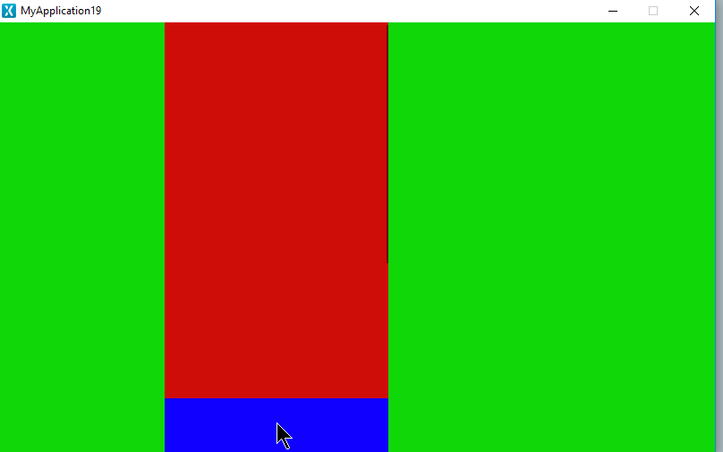

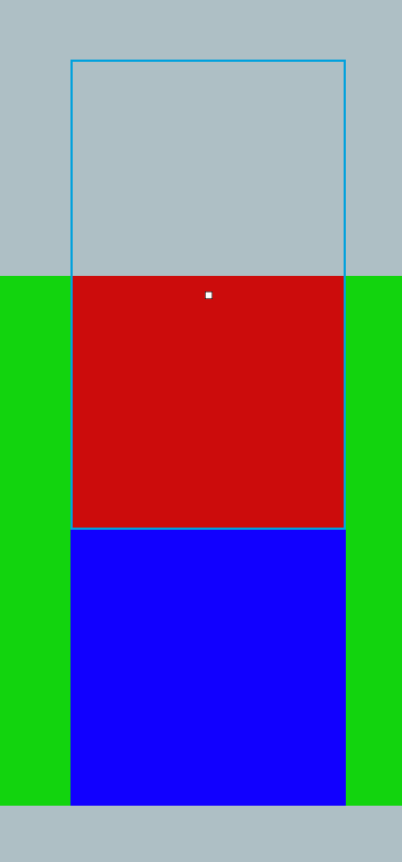

Here's a simple example. I created two large custom containers that contain a box each (gree and red, respectively). I added those to the scrollable container by simply dragging them from the project overview (after adding them to canvas) into scrollablecontainer1.
I made the canvas look like this:
And i can now drag the list containing the two elements:
Sandy.Dahl
Oh, that was simple, I tried adding the containers by clicking on them. Thanks!
