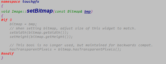

What puzzles me is:​ I modified the code as below, all images still display normally. So I think may be there is an same class and same function(setBitmap) in the touchgfx lib, the function in touchgfx lib is the one that is actually available.
The reason I am modifying the code is hard to say clearly. Due to insufficient RAM, I have to store the image data in Norflash. I tried to redefine LOCATION_EXTFLASH_ATTRIBUTE, but the hardware does not support this feature. Therefore, in order to display the image, I must first cache the bitmap into RAM and then display it using the function "dynamicBitmapCreate". There are hundreds of images, I don't want to modify them one by one. If I can modify the function "setBitmap", I can easily modify the display method of all the images.

The code I edited is not wrong, it can be built successfully.
I added a log, but this log is not output when the project is running.
void Image::setBitmap(const Bitmap& bmp)
    printf("Enter the setBitmap function. \n");
    bitmap = bmp;
    // When setting bitmap, adjust size of this widget to match.
    setWidth(bitmap.getWidth());
    setHeight(bitmap.getHeight());
    // This bool is no longer used, but maintained for backwards compat.
    hasTransparentPixels = bitmap.hasTransparentPixels();
And I remove all code from this function, ​all images still display normally.
So I think the only possibility is that this function has not been called. And the strange thing is, this function is indeed linked to my app.
