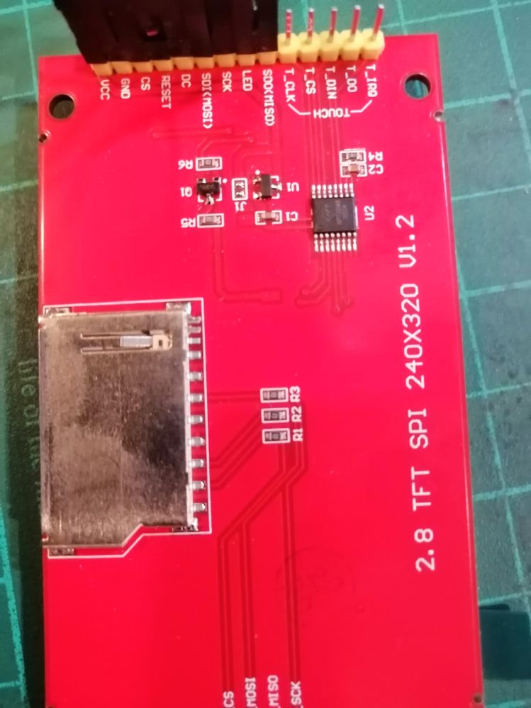

is not working in cube IDE. I tried it using cubeIDE v1.10.1, GFX v4.20.0, cubeMX v6.6.1. The code compiles no errors. But the TFT shield is blank ! Can you help resolve this useful application. My implementation project zip file attached.
