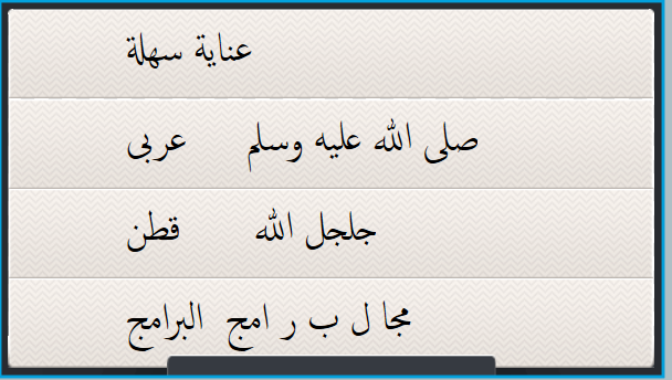

This picture is, what I see in the designer:

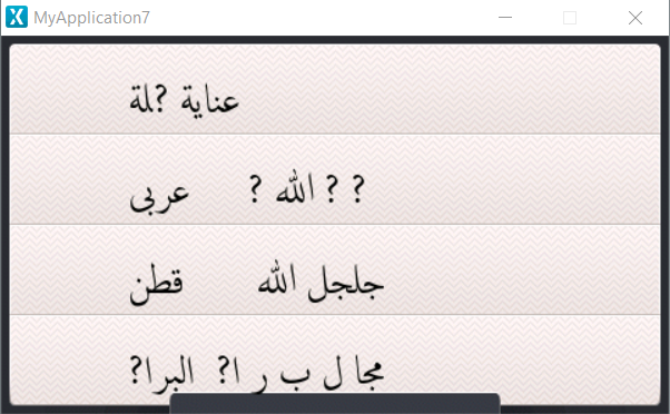

and this is the picture, what's the outcoming from the simulator:
Have you any idee?

Just to let everyone know, the issue was handled offline and was due to a font that did not cover all the right glyphs in the unicode range for arabic.
