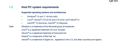

Hello @st_otto
In the meantime, STM32CubeIDE 1.19.0 is not supported on macOS 26.1, according to release note RN0114.
