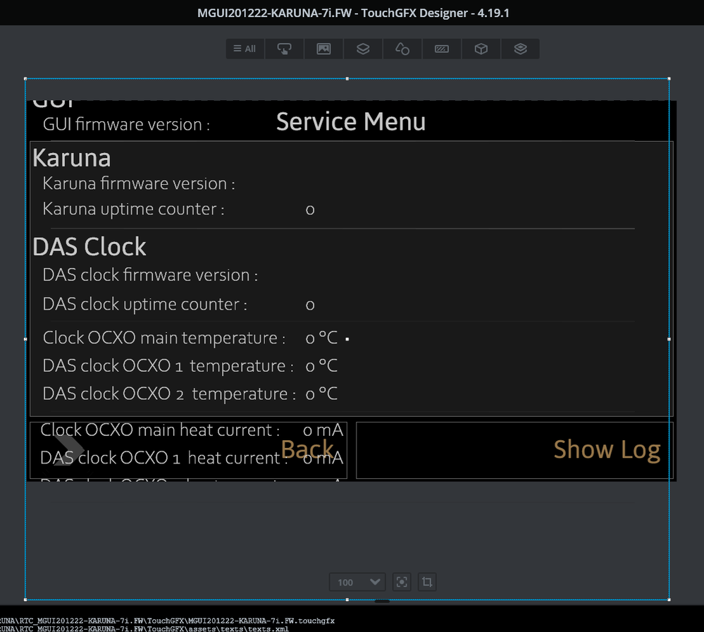

Hi ,
Please help me! How can I to scroll in design time in a scrollable container? I want to create an interface, what is have more info than can fit on the screen. That’s why I want to scroll , because that's it very complicated to do the design. Is this possible at all?
0693W00000Nrx0cQAB.pngThanks !

Hello @Károly Gulácsi​ ,
Unfortunately, that is not possible in TouchGFXDesigner.
If you want to have a better overview of your interface you can maximize the size of your Scrollable Container, and then resize it to the normal size before running the application.
Hope that this helped you,
/Yoann
