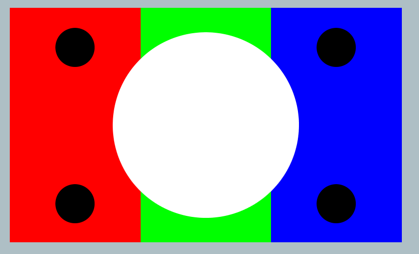

I changed the 4.3" 480*272 display on the stm32f746-disco board.
The new display is a 7" 800*480. I modified the resolution from code and also from TouchGFX project.

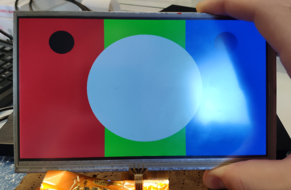

Everything is working fine. However the screens are displayed like if they are pressed from top and bottom.
To explain more. A prefect circle on the designer is displayed as an oval shape on the display.
Please see the images attached. Notice how the circle turns into an oval when displayed on the screen.
I need to solve this issue. Is this addressable by code or its a display problem?

The aspect ratio of the pixels on the display is not 1:1. The pixels are not perfect squares, they are shaped as rectangles. Is there any mechanism in TouchGFX to handle this issue?

If your pixels are rectangular, then maybe you do not have the resolution you thought you did? (Along the Y-axis, it seems). Wouldn't this be solved by simply adjusting your Y resolution?
But if your pixels were indeed rectangular on the y axis, then your circles should also be skewed, in my eyes. Are you sure?
/Martin
Hello martin,
This is the resolution mentioned in the datasheet, and actually wheneever I try to decrease the resolution. The image is not getting stretched , only cropped ( missing pixels going black).
Also when increasing the resolution, The pixels beyond the limit are not being displayed. They are beyond the boundary of the display.
So you're saying that you can actually solve this by lowering the resolution to compensate for the "length" of your pixels. It's a bit strange to me because, in my eyes, TouchGFX would need to render differently (A pixel in the designer is smaller than it is on the display for these types of displays and your assets would also have to be different - And yet, the output looks normal.
/Martin
Sorry , no I am not saying that. I am saying the exact opposite.
I just purchased a new display with square pixels. Apparently there is no mechanism in TouchGFX nor in LTDC to componsate for such skewed pixels
