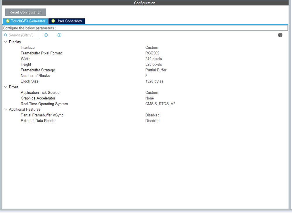

thank you for your answer. So far, I tried the following, all with help from the CubeIDE:
I created an application (1) targeting the STM32F207VG and set up FreeRTOS, CRC and the FSMC for the display
I created an application (2) targeting the STM32F407VG and added TouchGFX and FreeRTOS.
In TouchGFX Designer, I simply added a button and created code.

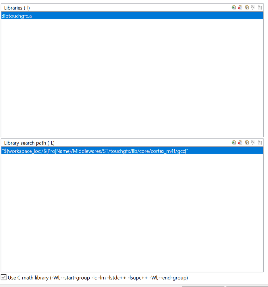

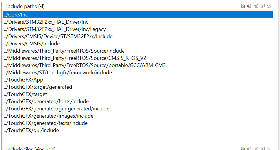

I then tried copying the TouchGFX and Middleware/ST from application 2 to apllication 1. I added the include paths to the C and C++ sections in application 1 and libtouchgfx.a from the core_m4f/gcc folder. I then had to exclude the Middlewares/ST/TouchGFX folder from building. Is this correct?
I then tried to implement the methods described in the TouchGFXHAL.cpp, so touchgfxDisplayDriverTransmitActive() and touchgfxDisplayDriverTransmitBlock().

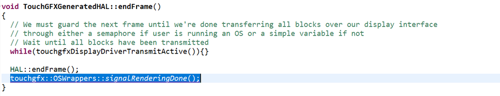

Now I am stuck at two problems. In TouchGFXGeneratedHAL.cpp the method DisplayDriverTransmitBlock(...) is being called in flushFrameBuffer(...), but only touchgfxDisplayDriverTransmitBlock is defined as extern "C". Is this an error in the generated file? The second error is an undefined reference to touchgfx::OSWrappers::signalRenderingDone(). I made shure that the corresponding cpp file is being compiled, but the error continues.
Did I miss something? Are the includes correct?

Looks like there has been no activity on this post for 21 days but I too am seeing both these problems using an SPI partial buffer strategy.
Adding touchgfx prefix to the mismatched name will fix the DisplayDriverTransmitBlock() problem however that then results in the undefined reference that Jonas has encountered.
This is re-using UI code which was previously working for a project built using 4.14.
Anybody got any ideas on this? In the meantime I've reverted to 4.14 on this new project. But since it uses a partial frame buffer strategy I'd rather like to make use of whatever improvements have been made as mentioned in the release notes.

This is an known issue that will be fixed in the next release 4.16 coming out end of this year.
The signalRenderingDone() function is not implemented correctly. To solve manually this issue, simply add the following code to your OSWrappers.cpp
* Signal that the rendering of the frame has completed. Used by
* some systems to avoid using any previous vsync.
void OSWrappers::signalRenderingDone()
osMessageQueueReset(vsync_queue);
Very sorry for the inconvenience.
