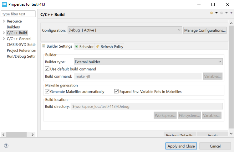

Hi everyone,
I'm trying to compile the touchGFX project (Simulator only) using the GCC Cross toolchain from the CUBEIDE but after importing the project to my workspace the build button is not enable.
I wonder if an additional configuration or compiling tool is needed.

I have never done it, so I need a bit more information ^^.
I suppose that you have modified the build setup within CubeIDE? You changed the initial build command to the simulator command "make -f simulator/gcc/Makefile -j8" (with I suppose "make -f simulator/gcc/Makefile assets -j8" beforehand) ?
What changes have you done exactly?
