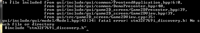

ANSWER - TouchGFX Community repost - Ajith P V - Jan 2017
 I have downloaded, compiled and run the below demo on simulator:
 http://ftp.draupnergraphics.com/TouchGFX/demos/Demo2016-source-769-Discovery.zip
But when I compile the same demo for ST platform, I'm getting error as shown in below image snippet:
Why it is showing this error for ST? Is it a working one for ST platform?
ANSWER - TouchGFX Community repost - Martin Stig Stissing - Jan 2017
Hi Ajith.
This demo is only supporting IAR so far. You can open the IAR7 application.eww project and try this out.
You might be able to add GCC support by altering the Makefile into including the right files. You need to alter the board_name to ST/STM32F769I-DISCO and setup the right paths to include the Middleware files needed
