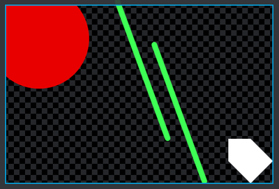

You can also try to just make a screen with boxes, circles, lines and other widgets that do not require to be stored in memory (this way the memory won't be used, only the rendering will be limiting).

Experiment 4 - Shapes instead of images
Per your recommendation, I tried adding shapes instead of images to see how this affects the system.
The capture is seen below, with 12ms of render time on the double framebuffer setup.

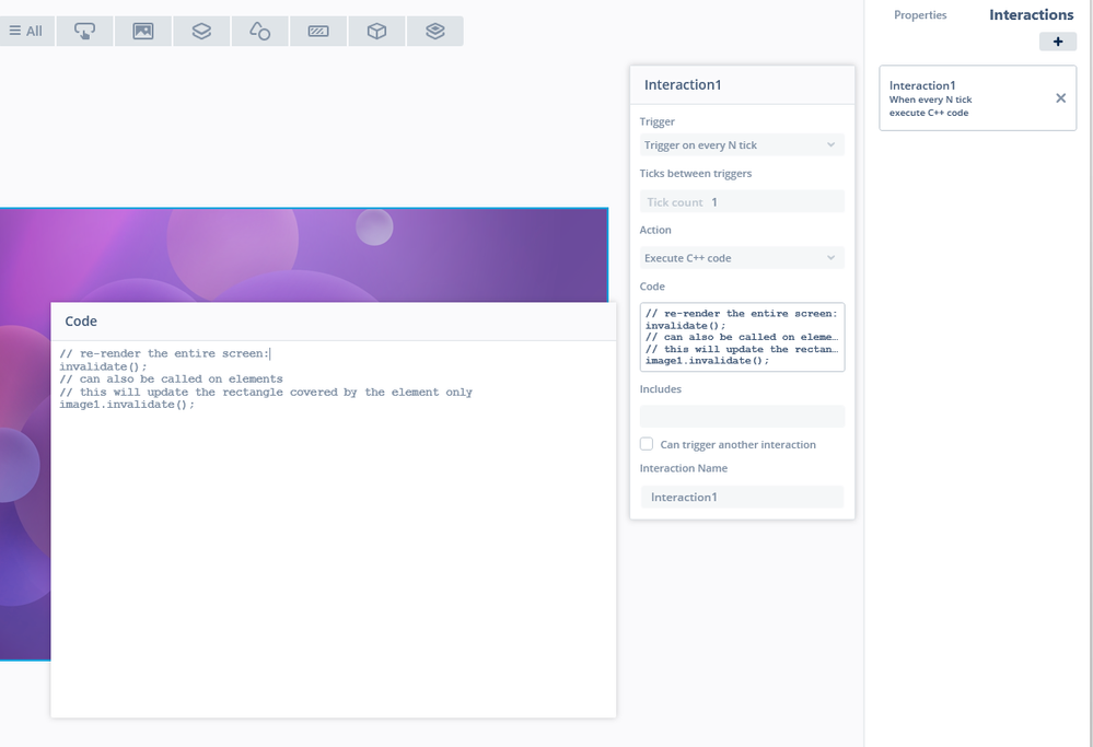

TouchGFX will only render areas of the screen that has actually changes since the last render. This is the reason that you render time is 0 for many frames. If you want to continously render a screen for testing purposes, you can create an interaction on it as shown in my screen shot.
The frame rate signal is a representation of how often a newly rendered frame is shown on the screen (the buffers are swapped for double buffer). It will toggle when a render starts and toggle again at the vsync after the render finishes. For LTDC screens without double buffering you will experience tearing if render (half period) time is higher than vsync(full period), for double buffer it will lead to lower frame rates, so choppy animations and so on.
It looks a lot like a memory bottleneck on either you flash or ram.
Can you elaborate on your external memory setup?
Where are your frame buffers placed?
Have you enabled DMA2D and/or GPU2D for TouchGFX?

Hello, I'm back from easter break :)
How does your performance look if you invalidate the entire screen as I showed earlier each frame in your UI?
I would like to confirm that each frame would then take the same amount of time as changing to and from it, unless you are using transitions between frames?
I can see you have had MCU load showing in your measurements earlier. I would expect MCU load to be very low in a scenario like this, since the MCU hands off all asset transfers to DMA2D, which transfers the assets directly to flash. I would expect at least a little bit of MCU work for each frame though, especially with overlapping elements. How quickly are you sampling the measurements?
Regarding the stretched vsync, my guess is that the screen changes are triggered by touch screen input, and you are reading those in an interrupt triggered by a GPIO pin with higher priority than the ltdc interrupts that controls the vsync output.
If that is the case, I would recommend just setting a flag in the interrupt and checking the state of that flag in STM32TouchController::sampleTouch() and reading the touch points and resetting the flag if the interrupt has set the flag.
You can also try to set another trigger for the transition, for example a hardware button press or a certain amount of ticks passed.
