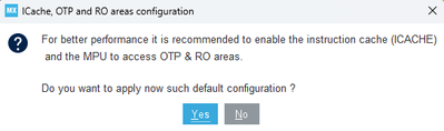

  • Click yes on enabling ICACHE and MPU

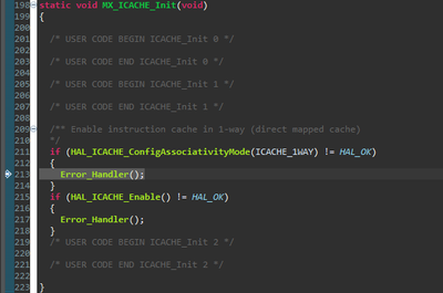

After connecting to the board with Debug Authentication it seems to hang in
MX_ICACHE_Init -> if (HAL_ICACHE_ConfigAssociativityMode(ICACHE_1WAY) != HAL_OK) -> Error_Handler()
Why would it go into Error_Handler out of MX_ICACHE_Init when this is enabled by default by CubeMX? I haven't changed anything on this.

When I comment out MX_ICACHE_Init() it works fine!
So for some reason the MX_ICACHE_Init() function causes issues...

This issue is very probably related to the fact that Icache is already enabled in STiROT.
The MX_ICACHE_Init is expecting an execution from non active cache.
So, you need first to deinit the cache if it is not setup in the way you want.
