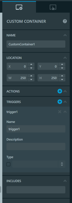

In building a callback with an argument, I need to add a custom action with a type, as explained in Tutorial 5. However, I could not find the "TRIGGERS" group in the properties tab of the container. There is only "Trigger" but can't add a custom action to it.

The "Triggers" section is found in the "Custom Container" tab on the right side of Designer, and not in the interactions tab.
Did you have a look at the documentation on how to create your own custom triggers? There is more info that might help you and some code to guide you in the process. 0693W000001qD7IQAU.png
If the Triggers is not there could you send a screenshot of what you have and where you are looking for?
/Romain

I realized it, the "TRIGGERS" section is available only for Screens and Custom Container. I intended initial to "custom-trigger" a regular container, but it seems that the feature is not available for it.
