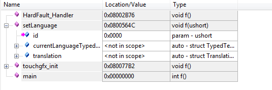

I have homemade board with STM32F746, memory - n25q128.
Project generated by Cube 5.5 and touchGFXDesigner 4.13
IDE - KEil 5.29
I put one button to main screen.
When I put images to internal flash - all works very well.
But when I put it to QSPI - I get HardFault, with this callstack

What's wrong?

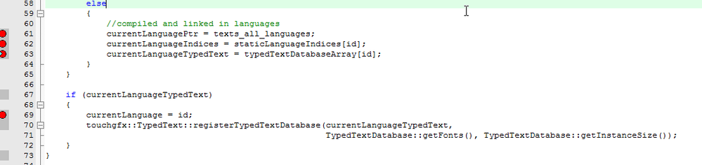

Additional info
system go to HardFault after string "currentLanguageTypedText=typedTextDatabaseArray[id]; "

Problem solved.
I forgot to enable MemoryMapped Mode.
I have enable it and program works
But pictures steel absent on screen...
EEuge
Senior
This problem is solved too!
In my course "application tick source" was custom. I set it to "LTDC" and displayl works wery well!
