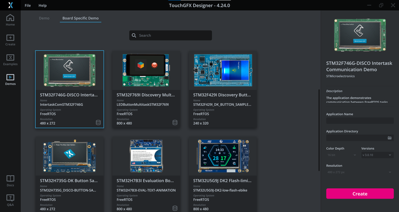

I tried to send a LIN frame by creating a task .
The code didn't conatin any error but the frame wasn't sent
What could be the problem ?
This is my project
Best answer by Mohammad MORADI ESFAHANIASL
Hello @Oussama_Baklouti,
As @mƎALLEm mentioned, there are no custom code for the sendData() function that you have defined for your button. Please refer to the following documentations to learn about communication of TouchGFX with backend.
Backend Communication
MVP Design Pattern
Screen Definition
You can also take a look at the Board Specific Demos available in the TouchGFX Designer, like STM32F746G-Disco Intertask Communication Demo
STM32F476G-Disco Board Specific DemoSTM32F476G-Disco Board Specific Demo
I hope this helps you!
MVP Design Pattern
Screen Definition
