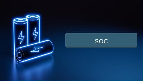

Thank you for sharing your project but I didn't reproduce the issue and the application passed SCB_EnableDCache() step and I see this screen (stepped over SCB_EnableDCache():(
Your project is running well in debug and in standalone.
Try maybe to use the latest tools CubeMx/CubeIDE and clean/rebuild your project.
