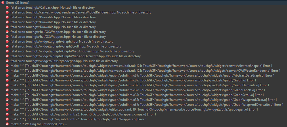

Hello, I am working with TouchGFX Designer version 4.25.0 and STM32Cube IDE 1.13.2 .
Since today my build process does not work anymore and I get errors that some of the .hpp files are not existent. error notificationserror notifications
I did double check the "missing" files but they are existent.
Has anybody already had this problem and maybe can suggest a solution?

Exactly (absurd) normal, after ioc edit and generate code one step is required open tgfx project and too regenerate...
Alx237
Hi MM..1
Thanks for your quick response!
I tried your solution but still get the same errors unfortunately.
Then maybe your cproject file is corrupt or project require refresh... You dont get info what you do...
